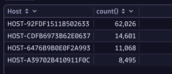

Hey @Aaron_L ,
A quick way that might help you achieve your objective is setting up a notebook and running this DQL query:
fetch logs
| filter matchesPhrase(content, "bypass")
| summarize count(), by:{Host = dt.entity.host}
| sort `count()` desc
This will fetch all logs, find the ones with "bypass" in content, and display the number of logs per host sorted by desc.
It will provide a table similar to this:
(this one is from the demo live environment)
Note that this does not provide an average of lines/hr, but the total count of lines with "bypass" per host within your selected timeframe. Naturally, the Hosts with more lines per hour will still very likely rank higher on the list of total count. So this can still be used to identify the list of servers exhibiting this specific high-volume logging behavior.
And keep in mind that, on Notebooks, you can always make use of the timeframe selector to adjust to your needs and specific hours:
(I used last 2 hours)
Lastly, if you're planning on having a dashboard with this query it might be worth to look into bucket assignment and optimize the query to look into specific buckets.
Let me know if this helps you 🙂
