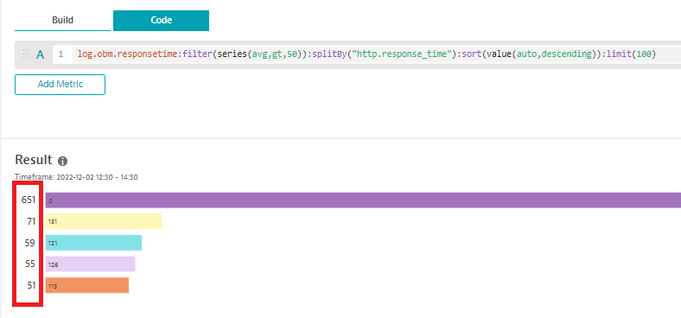

Hi @DynaQ,
I have tried to find a solution for you but I am failed. Maybe you or anyone else could reuse some part of it.
I have created a log pars for an access log where there were response time data.

I have created a 2 types of log metrics from the http.response_time for test purposes (please find attached).
Then I have tried to vizualize it and use the filter (with gt - greater than) method without success, because the filter applied for the occurances of the individual response times. Maybe sombody can correct my solution form the community.
I hope it helps.
