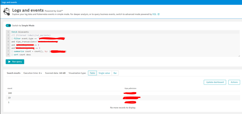

Hello people
I need to create a pie chart based on the data that comes from BIZEVENT.
I'm not sure if I should create a metric, a custom metric, or something like that. Please help me. Thank you in advance
28 Jul 2023 01:11 AM
Hey Ellery,
If the platform is soon to be an option for you, you can create pie charts using notebooks or the new dashboards for bizevent/log data. Edit visualizations for Notebooks and Dashboards | Dynatrace Docs. The docs for pie charts takes you back to dashboards classic but they are available.
If the platform is not soon to be an option I would recommend turning them into a metric to allow for more complex visualizations as the following docs don't mention pie charts as being supported in that view. Logs and events viewer | Dynatrace Docs
Hope this helps!
