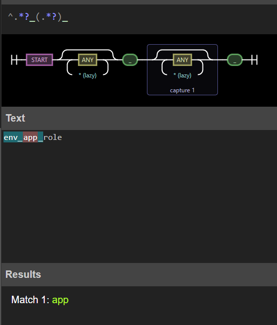

Application:
HostGroup:Name/^.*?_(.*?)_}

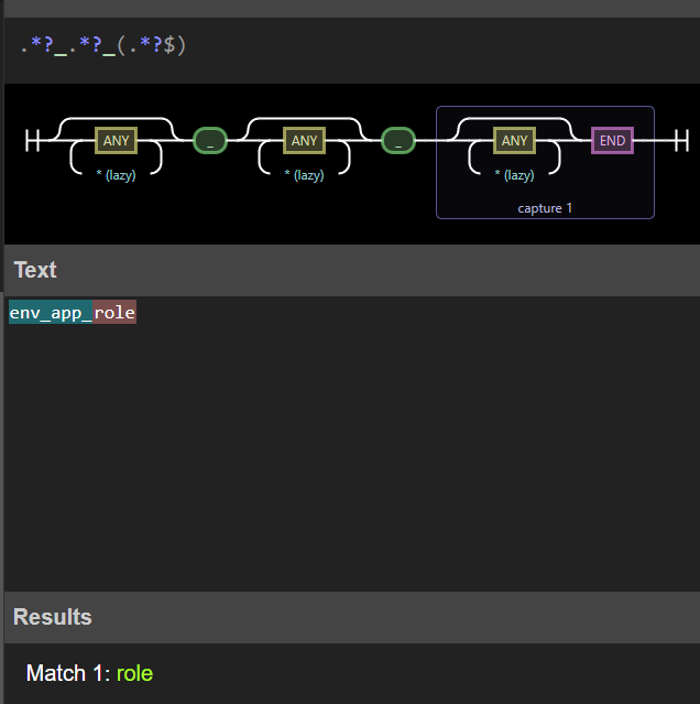

Role:
{HostGroup:Name/.*?_.*?_(.*?$)}
