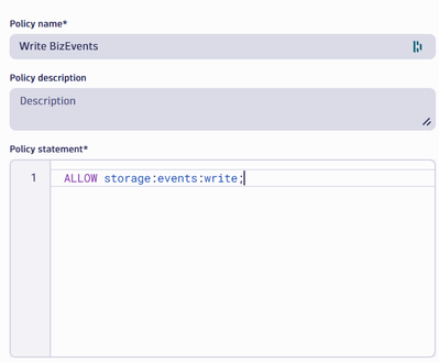

@deni If its just " storage:events:write" that is missing , create a policy with the missing permissions and assign it to the group the user is part of . Here is a example of policy
