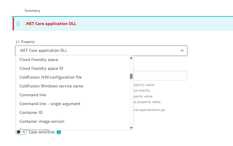

Hi @Babar_Qayyum
The "Command line" and "Command line – single argument" properties I mentioned are on the Dynatrace side and are available when defining custom Process Grouping Rules, screenshot below
let me add some insight about these two
1. Command line changes and entity IDs
This only affects process entity IDs if a custom Process grouping rule is defined under "Command line". Since you have no custom grouping rules and rely purely on OOB detection, command-line changes alone should not generate a new process entity ID for your IIS processes.
2. Where "Command line – single argument" actually appears
This property exists as a detection rule condition (under "2. Define detection rules"), not as an ID-source property. It's used to decide which processes a rule applies to, not how the process group ID is calculated. Under the ID-source section (3.1.2 Property), only plain "Command line" is available as an option.
To determine the exact cause in your environment, I'd recommend check the OneAgent log right after the IIS process (re)starts it shows exactly which inputs were used to calculate the process group ID for your process. This is the most reliable way to pinpoint the cause.
