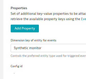

Customer ask to create a metric event on http check response time and set the impacted entity as the http test.
We have tried to use the Add property with http check, http step, synthetic monitor and monitored entity but the problem keep showing under impacted the environment and not the synthetic test....
Any one knows how to connect the metric event to its entity?

Hey @Yosi_Neuman ,
This metric does not have the synthetic test dimension, just the step and geolocation. Probably this is why it gets assigned to the whole environment. I'd recommend deleting the metric event and creating that from scratch.
I tested it in my lab, and I've been successful (the same metric) with assigning it to the synthetic test step, for example.
Hi @Julius_Loman
Thanks for your hint!
Using splitby() instead of splitBy("dt.entity.http_check") cause the problem!
Now its working like a charm
