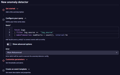

Hi @Vikas_g1997
Try using Davis Anomaly Detector.
And there you have to use query with makeTimeseries command. And put 500 or 1000 in the threshold value.
I never created a Metric event like this, but try creating yourself.

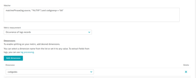

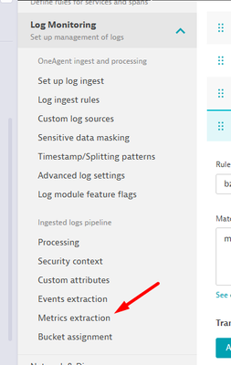

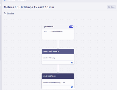

Hello, how are you? I have achieved it with metric extraction
or also with workflow if the query is very complex
