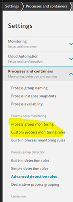

Please someone highlight me the exact differences between PG monitoring and Custom PG monitoring rules in Global settings->Process and Containers->Process Deep monitoring.

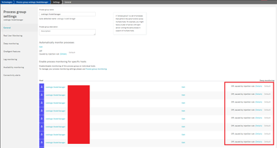

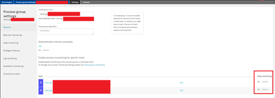

With Process Group monitoring you can globally set the deep moniotring of recognized processes (on/off). You can check it at the individual Process Group settings as you see.

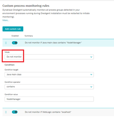

Custom Process monitoring rules can be use eg override the global rule above. See an example. I did not want to deep monitor the nodemanager process globally (it is not included in the Built-in process group monitoring rules - next menu item).

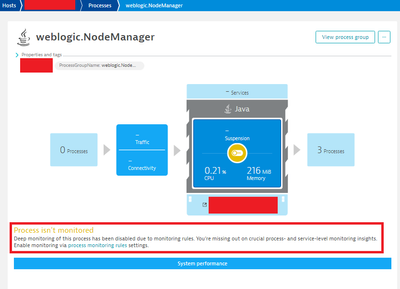

This is the result:
