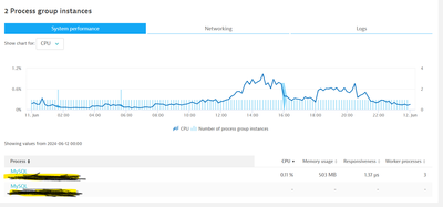

We are observing duplicate MYSQL Process group instance creating for some time with Shutdown mode and then we are getting false alerts.
Is there specific reason to detect Duplicate process group instance for some time? And how to remove this?

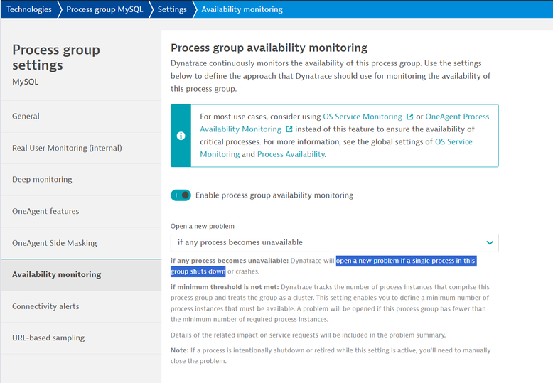

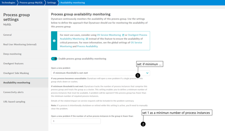

Hi @VenkataSainath ,
First, please check if the duplicate process group instances have different PIDs (Process IDs). These might be different because the new instance is a different process following a restart or shutdown of the MySQL process.
When the first instance shuts down, Dynatrace detects it as unavailable and may create a problem if you have configured alerting for this process group.
To avoid false alerts, you can adjust your anomaly detection rules for this process group. This way, if you are certain that these process groups should operate with only one instance, you can prevent false alerting.
DEFAULT OPTION:
MY RECOMENDATION:
12 Jun 2024 03:48 PM
Hi @JoseRomero ,
Yes, I can do that But why other process got detected and it always in shutdown mode.
And the process uptime is more than 16days and not restarted also.

21 Jun 2024 09:28 PM
@VenkataSainath most likely this is due to multiple processes running. It must not be a MySQL server process, but a other MySQL process falling into the same process group. Be sure to check metadata for each process in the process group and compare.
