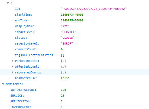

However when I access
https://xxxxx.live.dynatrace.com/api/v1/problem/feed?Api-token=putyourapitokenhere
But this also only lists 3 events although it says has 538
