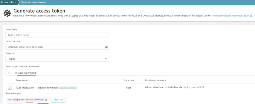

try to open "Access Token" from the navigation menu and generate it manually and select `InstallerDownload` scope.
BR,
Mostafa Hussein.

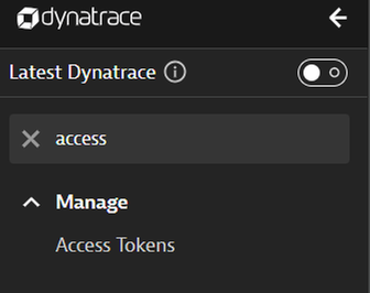

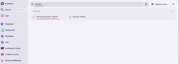

27 Oct 2024 09:36 AM - edited 27 Oct 2024 09:39 AM
in old view of Dynatrace it looks like the below screenshot
and this is the view in new Dynatrace UI
BR,
Mostafa Hussein.
31 Oct 2024 05:43 AM
Access tokens not Personal access tokens

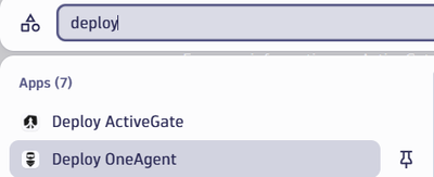

Hi @blade , If you are getting the "Failed to generate download token.", it could also be because of the user permissions . Please check if you have the needed permissions to generate an access token and download active gate
https://docs.dynatrace.com/docs/shortlink/sgw-install-linux
Also, if you want to use the old black background screen when installing active gate look for the " Deploy ActiveGate" and try navigating from there , you will be taken to a familiar old screen to install ActiveGate.
Looks like you are navigating from Hub which is a new interface

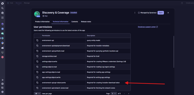

Hey @blade
This seems like it could be a permissions issue. Double check that you have the required permissions for the "Discovery and Coverage" app which is where it has taken you. To see what permissions are required for any app you can search for the app in the hub just like you searched for the activegate deployment. Once on the page for the app, under the "Technical information" tab you should find the permissions required and a description for why they are. As seen below, for creating deployment tokens the "environment-api:api-tokens:write" permission is required.

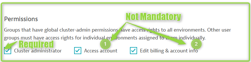

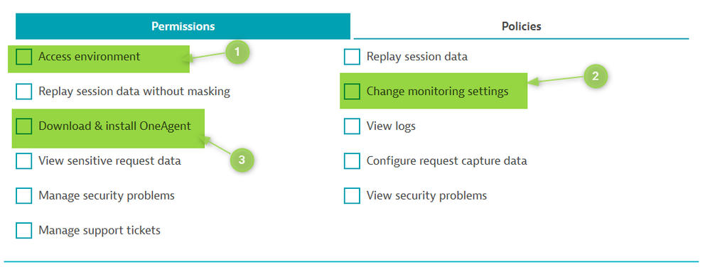

In case of Dynatrace managed deployments to generate a token you should have either one of the following permissions:
KR,
Peter.
