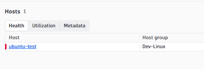

I have completed the entire setup in my lab environment. Please see the details below:
As you have already created the Host Group, the first step is complete. In my test environment, I created a Host Group named Dev-Linux, and the host is successfully associated with it.

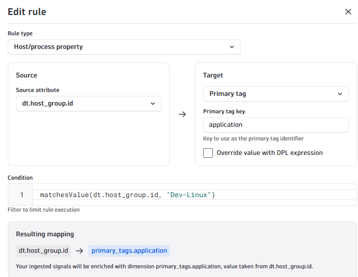

The next step is Ingest Enrichment. Here, you can map the Host Group to a Primary Tag. In my configuration:
  • Source attribute: dt.host_group.id
  • Target: Primary Tag
  • Primary tag key: application
  • Condition: matchesValue(dt.host_group.id, "Dev-Linux")
This configuration automatically populates the Primary Tag with the Host Group value. The dt.host_group.id attribute resolves to the Host Group name and is mapped to primary_tags.application.

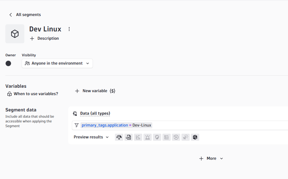

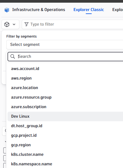

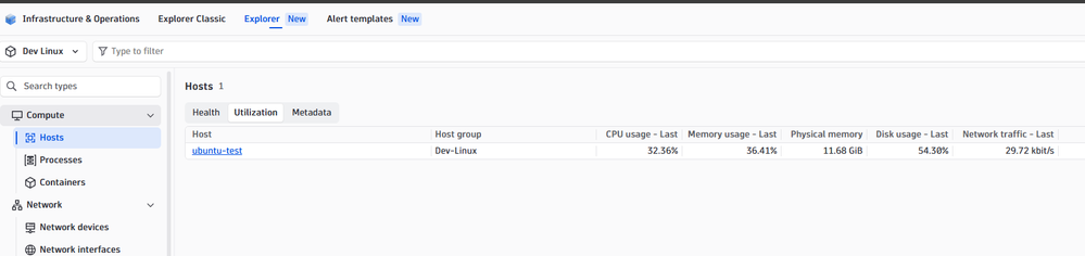

Finally, I configured the Segment using the Primary Tag created by the Ingest Enrichment rule. After the configuration was completed, I was able to see the Dev Linux segment under the Infrastructure & Operations application, and the host associated with the Dev-Linux Host Group was displayed within that segment even other components too like process, containers, logs etc
Now i can see segment under Infrastructure app

You can also validate the data directly from the Segment settings page. Open the segment, click Preview, and verify whether the expected data is visible. If data appears in the preview, it confirms that data is being ingested and matched by the segment configuration.

I suspect you're using Services -> Explorer. The issue is related to a known limitation in the default Explorer view, which does not fully support Segment-based filtering. As a result, no data is displayed when filtering by Segments.
The Explorer (Early Access) version has native Segment support, which is why it works correctly. In screenshot I have selected Early Access version.
To avoid switching back and forth, you can make Early Access your default:
  • Go to Services
  • Enable the "Use latest features" toggle in the top-right of the app header
Let me know if you're still not seeing the data after enabling it.
