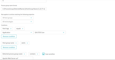

All,   I'm have a process that runs on all of our Windows machines,  "ProcessName1".   When I go to the Technologies view in DT I see a very long list of all the locations this process is running, so imagine the name "ProcessName1" repeated 100's of times with no other distinguishable characteristic.  It's like having 100 people in a room name "Joe".

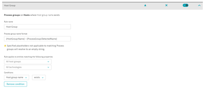

Every one of our hosts has a HostGroup Name.  To be able to determine which process belongs to which host or hostgroup I created a 'Process Group Naming" rule shown below.

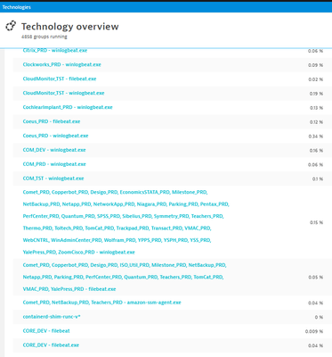

The problem I'm having is whenever i turn this on a process group is created that lists all of my HostGroupName values in alphabetical order until a character limitation is met.
What I expected was that on each host....if the Host Group Name EXISTS the rule would have pre-fixed the Process Group Detected Name with the HostGroup Name.
{HostGroup:Name} - {ProcessGroup:DetectedName}

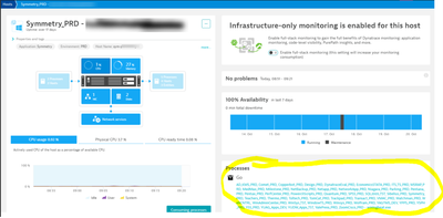

I'm actually looking primarily for the process groups to become better organized.  Once the process groups split up correctly, the process group instances will naturally fall in line.  The rule I applied works for the most part....out of the 700+ only 2 process groups are pulling in a bunch of servers.  You can see in the screenshot many others are naming correctly.   The problematic process groups, one is pulling in 172 servers, the other 44 servers. So, of the 1,300 servers monitored this is happening only to 216.

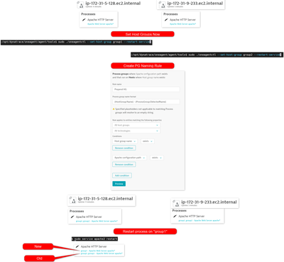

To demonstrate, in my demo setup (screenshot) I:
  1. Created 2 VMs and installed OneAgent with no host groups
  2. Installed apache2 on both
  3. Modified the host group while apache was still running and used --restart-service to restart OneAgent
  4. Both apaches are in the combined group
  5. Restarted only apache process on group1 host
  6. Notice a new group + old one (which will age away eventually)
