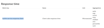

Hi Jan,
If you would like find more information about metrics please click the link below:
https://www.dynatrace.com/support/help/observe-and-explore/metrics/built-in-metrics
In this part of our documentation you can find all available metrics and their describes. In you case if you looking for data from client side response time you should to use this metric: builtin:service.response.client
You can download these metrics using our API v2.
This metric (builtin:service.keyRequest.response.client) only applies to requests marked as key.

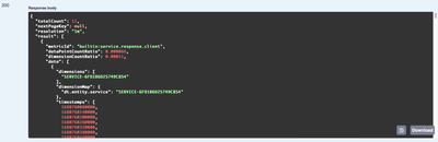

It's work for me. Below you can find my curl:
curl -X 'GET' \ 'https://<id>/api/v2/metrics/query?metricSelector=builtin%3Aservice.response.client' \ -H 'accept: application/json; charset=utf-8' \ -H 'Authorization: Api-Token <token>'
and response body:
You can through to the URL https://<your tenant>rest-api-doc and from DT's GUI help test the use of the API. Remember the proper token scope: metrics.read.

06 Apr 2023 09:01 AM
I can confirm that I also get results similar as mentioned above.

06 Apr 2023 09:33 AM
I also checked the api querying directly from Postman and everything works fine for me:)
