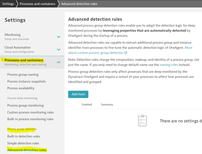

Hi, do you have enough metadata on process istance from the autodiscover of Oneagent in order to distinguish single PGIs?
If so you can go for a advance process group detection rule and define the "Process instance extraction":

27 Mar 2023 04:37 PM - edited 27 Mar 2023 04:38 PM
Then I guess you are near to a solution, if metadata allows you to enrich your process discovery mechanism,
Try it and let us know, but know that for the rule to be applied you'll need to restart the process itself.
This will discover a process as a new one, not aggregated to the previous process group you had.
In my case (in my org) the adopted hierarchy is:
process group = namespace
|___________>> process istance = full pod name
And reflected it via advanced process detection rule in DT. It is always about finding a common pattern 🙂
27 Mar 2023 04:42 PM
@y_buccellato Sure I added a rule however need a restart of processes. Thanks for quick guidance on this.
