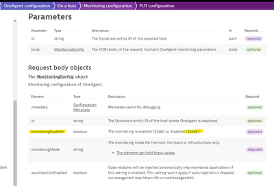

Once upon a time we used OneAgent monitoring configuration API - PUT configuration but this API is deprecated.

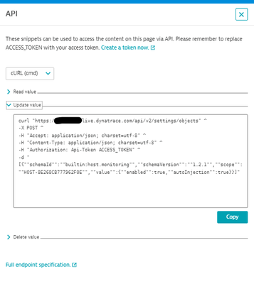

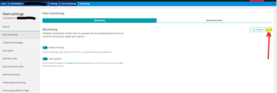

In order to use the current v2 setting api please go to the setting page of your host under setting --> host monitoring , use the ... on the right corner
in order to open the menu
and choose api
just copy the update api call and you are all set!

Submitted this payload (taken from the API section of the settings as you instructed:
{"schemaId":"builtin:host.monitoring","schemaVersion":"1.2.1","scope":"HOST-29200A0CBEF971B4","value":{"enabled":true,"autoInjection":true}}
