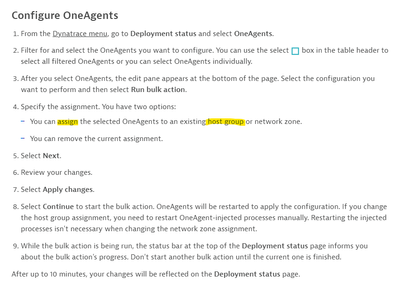

Hi @radek_jasinski  & @Chayaphot ,
You can utilize Remote configuration management using UI
HTH
Yos

Not quite agree with you @radek_jasinski, you can filter the oneagent deployment (let's say by tag) and then switch on the check box for all the hosts and you are all set.
If you have a tool to run the CLI on 100 hosts go for it!
