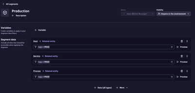

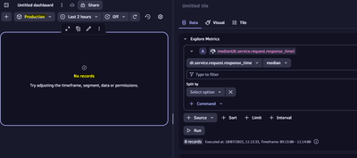

We are trying to apply segments to a basic dashboard (response time split by service). The segments are configured to split the data by environnement (prod, qual, preprod...). We are using tags on host, process and services.
Unfortunately, this configuration doesn't display anything on the dashboard when it is applied. Do you know what could be missing ?
hi @JMBMinint
You're assuming that filtering on entities would imply that the filter is also applied to the data that is linked to entities, as it is the case with management zones. With data stored in Grail, this is not the case. You have to include in the segment definition also the "data".
