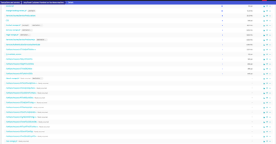

We are interesing in knowing all requests that have a service.
In one of our service we can see that:
We are interesting in knowing all requests; even requests ocurred extremely rarely.
Is it possible knowing that? Where can we see that=

You will see all the requests the only thing is that dynatrace will not added their measures

Ok, but as you can see, at the bottom of page, we receive the message "at least 2 contributors were skipped because they ..."
How can we see all of them and their measures? Is this possible?

With a standard setup, each Dynatrace OneAgent captures at least 1,000 new end-to-end distributed traces (aka, PurePaths) within each monitored process every minute (1,000/min/process).
You can choose to increase the number of entry-point PurePaths captured per process/minute in your most important environments to get even higher fidelity than the default. The upper limit is 100,000 new end-to-end requests/process/min. This effectively instructs OneAgent to capture all requests. This is useful when you need to ensure the capture of even rare requests within high-volume environments.
You can override the settings from the deep monitoring.
