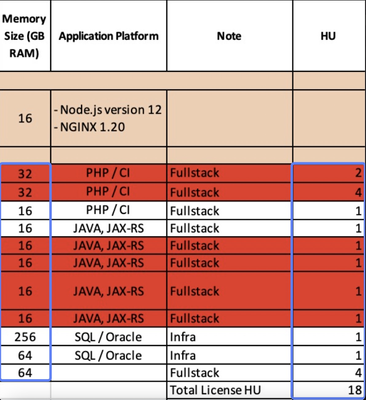

Currently I have a plan to deploy Dynatrace on 11 servers with total consumption 18 Host Units as attached below.
If I want to use ActiveGate, how to check minimum requirement for that ActiveGate? Is there any recommendation on how many active gate I should use?

Based on your list only one Env AG would be enough. Depends on your organization requirements (eg. HA) maybe you should set up more than one. For this not so long list of hosts the HW requirements are very low.
