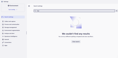

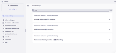

With this new update and looking into Gen 3 (where no Gen 2 is available) I've been trying to figure out how to automate tagging as we did in the previous generation. In the past, it was very simple to use 'Auto-tagging' rules, which then propagated across different levels.
However, with the latest update, this option is no longer available in the Gen 3 settings. It has been a real challenge to tag processes; I have found some documentation, but it isn't clear. Could you please help me find a simple and efficient way to achieve this?

@AntonPineiro  not true. You have the Hybrid environment with classic app functionality. The new pureGen3 environment does not have the classic apps (except DEM), so no auto tagging rules are possible and won't be possible.
@carlos_carreno I recommend looking at primary grail tags and primary grail fields. Tagging itself is currently possible using DT_TAGS or OneAgent tagging configuration. I understand the pain. But you should rely more on the new concept with primary grail fields. It's a huge concept difference.
