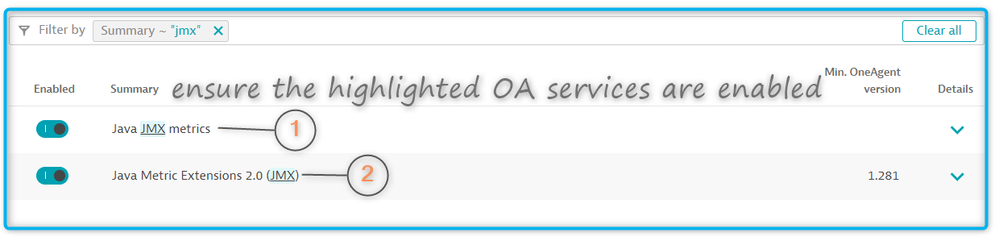

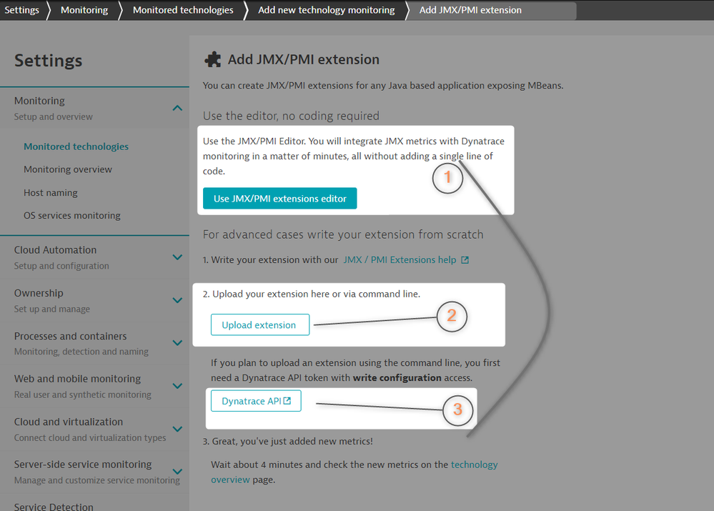

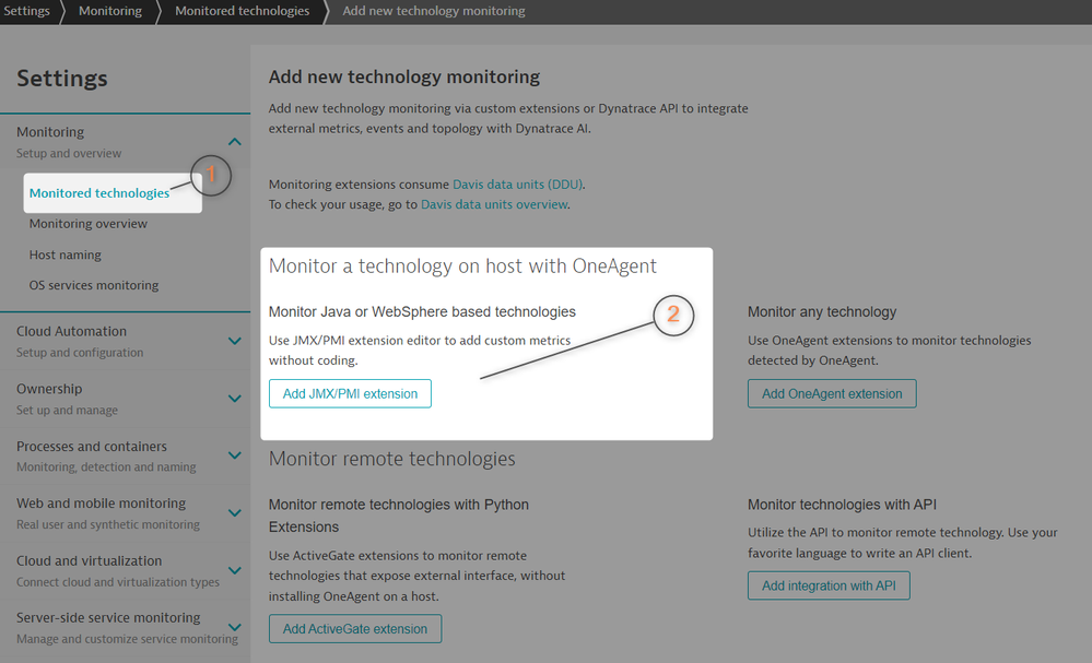

For the raised concern, you can configure it as per one of the attached examples
Through the UI
Dynatrace Hub
https://www.dynatrace.com/hub/detail/connection-pools-tomcat/?query=jmx&filter=all
This option require OA deployment which won't work for your case.
