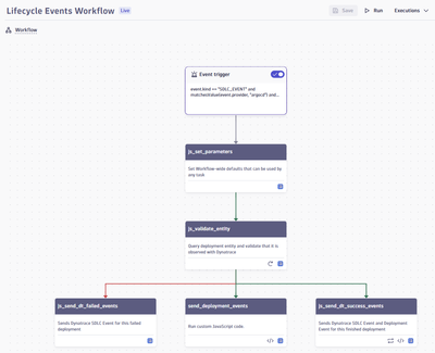

One option we have shown over the past years is to use a Workflow that triggers on such an SDLC event, then looks up the deployed entity in Dynatrace and then creates an additonal CUSTOM_DEPLOYMENT event attached to that entity. On the playground you can see this as the Lifecycle Event Workflow.
While this works - it has some limitations especially when you have hundreds or thousands of SDLC events coming in every day. Because- this means that this Workflow gets executed for every SDLC event - does a lookup - and then creates a new event just to make root cause analysis easier

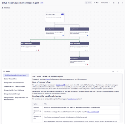

To better understand whether a deployment change is the root cause of a problem I thought about a different approach and implemented the SDLC Root Cause Enrichment Agent. You can also see it on the Playground.

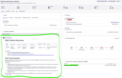

This one triggers when Dynatrace detects a problem (by default filter on problems that also have a k8s.namespace attached). That workflow then queries SDLC events (they dont have to be associated with an entity but have to have a namespace which most events by default do). If found it will create an impact and root cause analysis by using those SDLC events and general ki8s events. It then posts this back to the problem as a comment / annotation. See the result here
