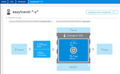

Here is information on process connections. You can get TCP connections using this doc.
https://docs.dynatrace.com/docs/shortlink/process-network-connections-monitoring
Goto the host and click on analyze process connections.
You will see something like this. Also similar connections will be in smartscape.
For using it as a metric, you can use the network metrics split by process or technology specific metrics are there that you can use for number of connections for example. Thank you.
