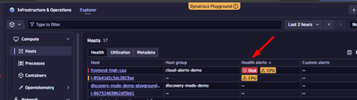

I'm monitoring a Windows Server 2025 host with OpenTelemetry Collector Contrib (v0.150.1) and sending metrics to Dynatrace via OTLP. Most metrics are flowing correctly (CPU, memory, disk, filesystem), but two key issues:
  1. Health column remains empty (shows -) in the Hosts view
  2. Process Count and Processes Created metrics are not visible in Dynatrace despite being configured and exported
Configuration

  • Mey are process count metrics and health status not appearing in Dynatrace?**
  1. For Process metrics: system.processes.count and system.processes.created are configured, exported, and flow without errors. Why don't they appear in Dynatrace UI?
    • Missing a required attribute or dimension?
    • Wrong metric naming convention?
    • Requires a different field/resource mapping?
  2. For Health Status: What does Dynatrace need to calculate and display health status for a Windows host?
    • Is there a specific health status metric (system.status, host.health, etc.)?
    • Do I need additional metrics beyond what's currently collected?
    • Is there a minimum frequency or volume requirement for health calculation?
    • Should I be exporting collector internal telemetry (otelcol_* metrics)?
  • Is there a Dynatrace-specific configuration or entity type required?

Hi.
I just looked at our Playground Tenant and there you can see 3 hosts being monitored through OTel. Two of them show processes with all process details, e.g: ==> https://playground.apps.dynatrace.com/ui/apps/dynatrace.infraops/explorer/Compute/com.dynatrace.exte...
Contact our DevRel team through devrel@dynatrace.com

Maybe my understanding for the field/column "Health Status" is wrong. What I have expected is to see some sort of OK or NOK in this column when there is a problem with the collection for a host.

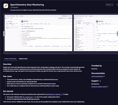

Hi @patmis
I reviewed your case and I'm sharing some suggestions for enabling Host Monitoring with OpenTelemetry, along with some key points about "health" that you mentioned.
Activating "OpenTelemetry Host Monitoring".
I think one of the issues you might be experiencing is related to the "Naming Convention" and using correct names for the necessary entities to be created/recognized in Dynatrace.
To achieve this, search for "OpenTelemetry Host Monitoring" in the Hub and follow the extension's configuration/installation steps.
Link : OpenTelemetry Host Monitoring extension — Dynatrace Docs
Important Definition:
(Note that this may differ from "Health," which will be displayed for "Host Entities" otel:host.)
"Health Alert": In Dynatrace, these represent confirmed problems that have a measurable impact on the health, performance, or availability of the system. These alerts are generated when Dynatrace detects a violation based on its automatic anomaly detection or predefined alert rules, and are categorized by severity and impact on the customer to help teams prioritize their response.
As far as I know, it's not explicitly stated that it won't work without OneAgent monitoring. Therefore, it suggests creating custom alerts that meet the specified conditions and validating them. You could also create a ticket with your question.
I hope helpful 💪
