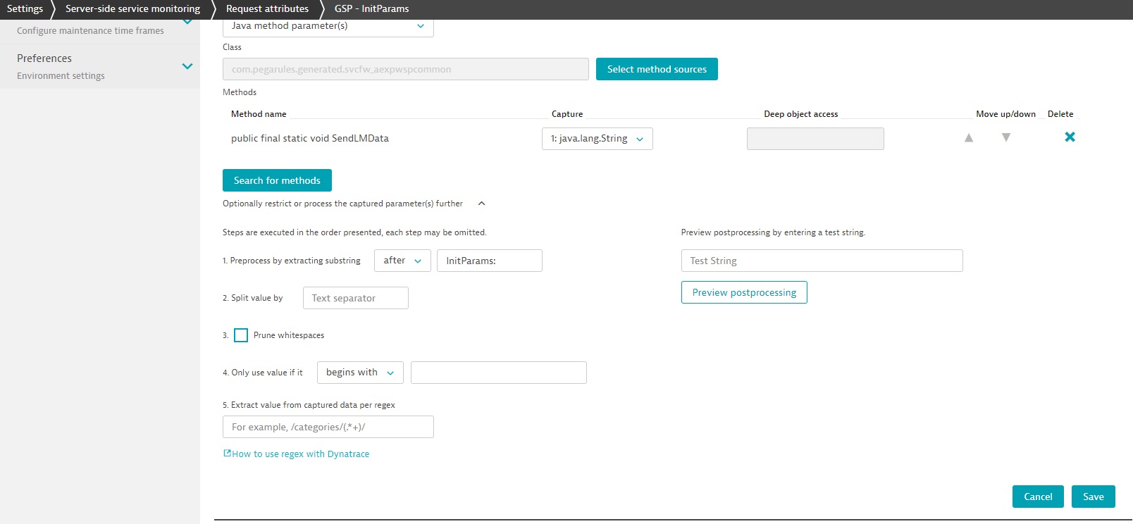

I am having a requirement to create a request attribute based on a java function which return a string. But in purepath its only showing first 251 characters only. Is there a way to increase this to 500 characters ?

No, it is not. You will have to use two request attributes. One for capturing first 250 characters and the other to capture the rest.
Thank you Julius. Is there way to get characters from 250 to 500 while creating Request attribute using a java method as given below.
Use the regex for that:
^.{250}(.{0,250})
If possible (not in this case probably, as the UI will not allow it), I'd use the construct
.substring(250,500)
in the deep object access.
