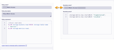

Hi @andre_vdveen I copy an example of what I have configured and it is working as expected. Hope it helps you.

I've set it up exactly as you have it there in the screenshots, and applied the policy to my group, then added my user to the group (allow access) and made sure my other user (test user, no access) is not in that group, but the test user still has access to the metric 😞
I must be doing something wrong here, clearly...

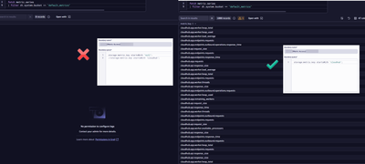

Look, @andre_vdveen This is a test group, same policy as previous post, and if I remove everything except the monitoring viewer and keep/remove metrics permissions, the user loses or gains access.

Thanks @DanielS, does that work in the Data Explorer too though? I think that's where the difference comes in, I was looking there 😉
I've tested it again via Notebooks and it works as you've explained...yet in Data Explorer, the user can still see and access the metric. That's a bit of a problem, since some users who're not yet comfortable with Notebooks, will revert to using Data Explorer and still have access to the metrics they're not supposed to.

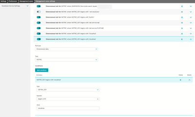

That's right @andre_vdveen for everything under the scope of the Classic Dynatrace I've managed everything with Management Zones and I allow or disallow metrics with the following rules:
Grail data access policies do not work with the classic schema, so during the transition it is necessary to manage both schemas. It may be a bit cumbersome but today we must coexist with both worlds.
