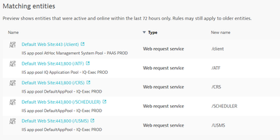

29 Jul 2021 05:31 PM
What output are you looking for specifically? Can you provide another example? This screenshot shows a preview of how Dave's rule above would work - does this not match your initial request?
29 Jul 2021 05:55 PM
Solution works.
