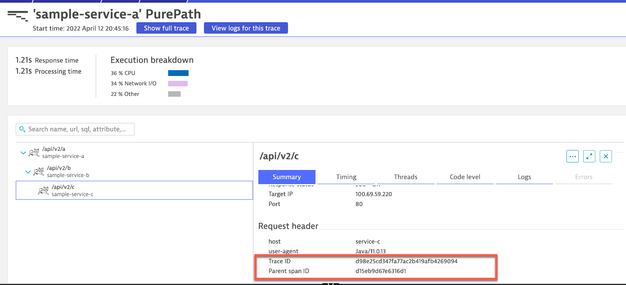

With this setup, the Dynatrace pure path for Service-A has trace ID and Service-B, Service-C have trace ID and the corresponding Parent span ID.
Sample screen shot for pure-path of Service-A that shows Service-C:
From tracing perspective this looks perfect, but I now need to access Trace ID(for all 3 services) and Parent  span ID(for Service-B and Service-C) in the application code, so that I can enhance the log messages with this metadata of trace Id and parent span Id for correlation. I have a separate central logging service to which we ship log data. But, unfortunately these values are not accessible in the request headers in the application. Is there any Dynatrace configuration to let Dynatrace send these values in the request header to application code.

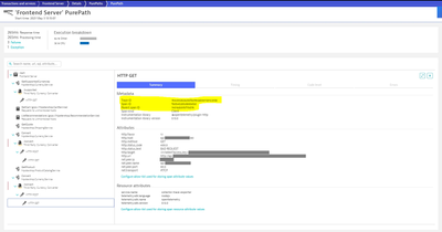

Hi @santosh_nv and @swin12 , I have the same concern. Indeed, I raised this idea (Improving the W3C tracecontext for log correlation) a year and a half ago (the idea contains even a picture that illustrates the lack that we perceive).
It is right that W3C Trace Context does not specify that the third field necessary for correlation -the real parent_span_id- should be introduced in the tracecontext or tracestate tracing headers. But solutions like Opentelemetry (aka. OTEL) include this field because it is necessary for correlate logs. So, how is Dynatrace correlating the spans and logs? I don't know, but I can imagine, but probably through some kind of internal pointer/reference to a some similar field. I think that Dynatrace should show the real parent_span_id at least in the PurePath, like Dynatrace does with OTEL ingested traces (see the picture picked from this Dynatrace's blog entry😞
