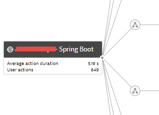

One outstanding issue that is a deal breaker for us is that dynatrace is creating a service for each controller within the spring boot app (see screenshot below).
The main issue with that is certain things like “pure path” (which is the heart of debugging for an application) doesn’t work very well. You can’t see purepath for entire app. You have to go service by service. So, only way to find your request is to know which controller it came from. If anyone knows if this is possible please let me know. Support told me it is not.

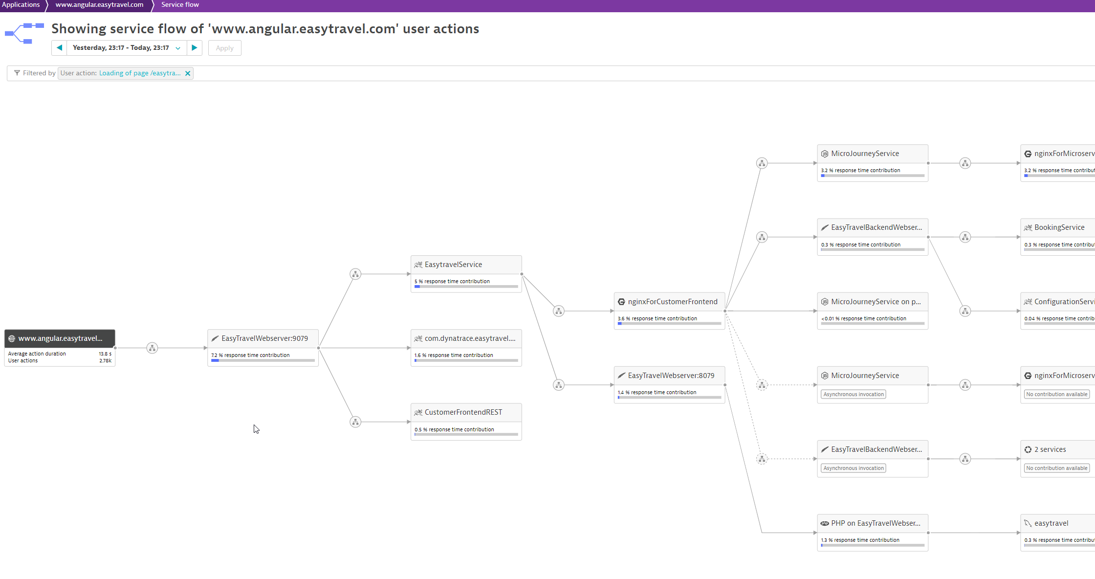

You still get the full end-to-end view via the service flow and PurePath. Just drill into the PurePath view from the first service that was called. An example:
Serviceflow from an application with many services:
Example PurePath spanning multiple services:
