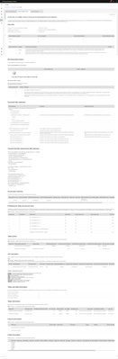

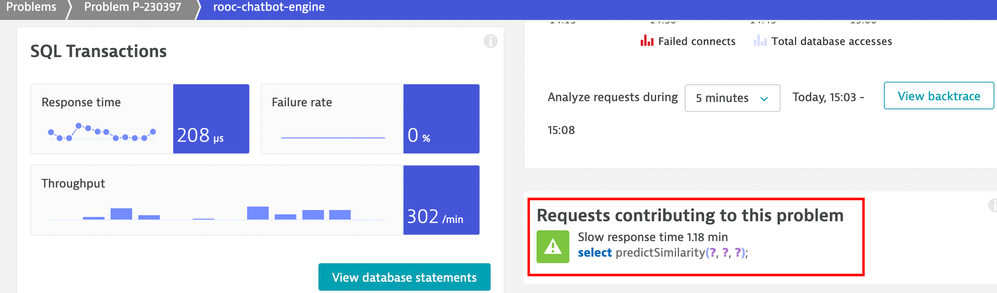

Recently I got a problem detected and the root cause is for Database as attached below:
I know the green color means it is already solved. But actually I just restarted the database.

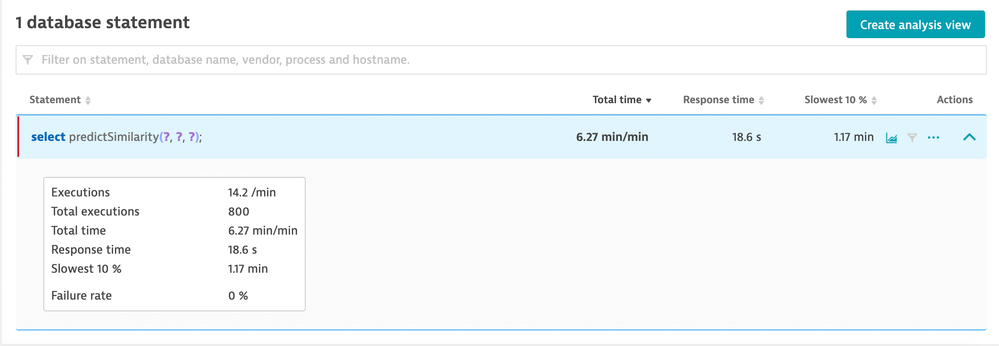

When I trace deep down, there is slow Execution problem as follows:
My question is, could Dynatrace give recommendation on what remediation I should do regarding that root cause?
Like maybe we should fix a certain query or maybe optimise some indexing regarding database.

Dynatrace will not give you a recommendation for that. however you will be able to see where is the issue easily, also, you can check the distributed traces to see what happened and the sequence of the executed queries, in your case maybe the issue is that the table is not indexed from the DB side and I might be wrong.

Unless you have oneagent installed on database too, information regarding queries to that db are read from jdbc connections. So actually no information regarding the db is collected and consequently no suggestions regarding optimizations can be evaluated.

Lets be frank here, Dynatrace gave You exact function that got slow. And the worst thing in fixing such things is that is a function. I'm guessing it's postgres, but engine is almost irrelevant. There is NO TOOL on the market than analyses functions and give you info how to improve them. Some tools (incl Dyna) can get execution plans for queries which You can use to optimize, some will try to do the same to procedure, but it works ONLY in procedure is actually just query and no logic/code. Functions and procedures are pain in... of every company that utilize them.

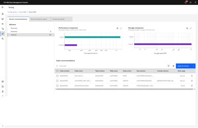

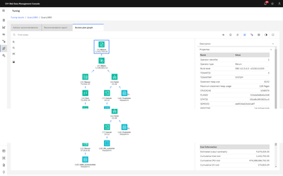

there are tools that show access plan and suggest recommendations
