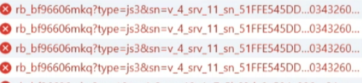

We have got Dynatrace classic oneagent deployed on our application stack and we can see latency issues and also getting page distortion and 404 error for beacons.
This has happened when we had DT global outage ..
Q - How any monitoring tool can slowdown or impact customer application when monitoring tool has any outage/issue..
see RUM errors for reference ..

As you've already noticed the RUM-related errors, I won't go into further detail on that. Instead, I'll come straight to your issue - RUM JavaScript Beacon (404 + Page Distortion)
Let me break down the actual error step by step.
rb_bf96606mkq - The beacon/RUM JS endpoint path — rb_ prefix = OneAgent-served RUM endpoint, bf96606mkq is your application's monitoring ID
?type=js3 -  The browser is requesting the RUM JavaScript payload (type js3 = the full monitoring script bundle) — this is not a data beacon, it's the script download itself.
sn=v_4_srv_11_sn_51FFE545DD -  Session/server context — srv_11 identifies which OneAgent server node was handling this
and finally
ruxitagentjs_ICA15789NPQRTUVXf - The specific RUM JS filename — ICA15789NPQRTUVXf is your feature flag/config fingerprint encoding which monitoring features are enabled
404 repeated 3 times - The same request failing three consecutive times the browser is retrying
The critical insight: type=js3 means this is the script download request, not a data beacon. The browser injected <script src="rb_bf96606mkq?type=js3&..."> into your page and that URL is returning 404. This means the RUM JavaScript itself cannot load so no monitoring runs at all, and the failed script request is what's causing your page distortion.
What's Actually Happening
Browser loads your page
  • OneAgent injects: <script src="/rb_bf96....?type=js3&sn=v_4_srv_11_sn_51.......">
  • Browser fetches that URL from your app server
  • OneAgent on your server tries to serve ruxitagentjs_ICA15789...... ->
    • OneAgent is lost cluster connectivity during outage
    • Returns 404 (cannot serve the JS bundle)
  • Browser retries the same URL → 404 again (x3 in your logs)
  • RUM JavaScript never loads → no monitoring

Summary of Your Specific Situation
Your symptoms map exactly to this: OneAgent auto-injects a synchronous <script> tag pointing to a dynamically-served RUM JS endpoint (rb_bf96606mkq?type=js3). During the cluster outage, OneAgent couldn't assemble that JS bundle and returned 404. The synchronous script tag then blocked or partially disrupted page rendering, causing both the latency and the visual distortion.
