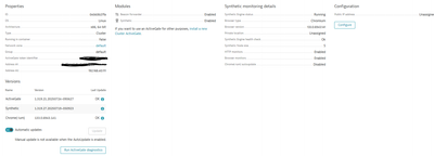

We have Dynatrace managed. In order to set a synthetic monitor, we will need private synthetic locations, the problem is that none of our 7 active gates and 1 cluster activegate is detected in the activegates section on the private locations details page.
Any ideas?

the cluster activegate is ona linux machine , and we followed the web ui docs which is similar to the one PacoPorro referred to , and yes synthetic is enabled on the cluster activegate as shown in the screen
