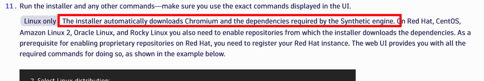

  1. You don't have to install chromium manually.
    From: https://docs.dynatrace.com/docs/platform-modules/digital-experience/synthetic-monitoring/private-syn...

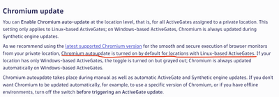

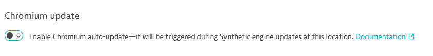

  3. It is automatic, if the Private Synthetic location has the "Chromium update" flag enabled:
    From: https://docs.dynatrace.com/docs/shortlink/manage-private-locations#location-details
  4. Yes, if you want to have it automated, the URL has to be accessible. If it is not accessible, you'll have to do it manually. If not accessible, you won't also have screenshots, as you mention.

3. If you do not set Chromium auto-update on the location then, yes, you will need to manually keep Chromium updated. It needs to be kept with 2 versions of the expected version for that ActiveGate version.

  1. For RedHat install, please follow the instructions in the Wizard for installing, it will provide you with the commands to execute. Using the wizard requires access to https://synthetic-packages.s3.amazonaws.com to download Chromium.
    If you don't want to allow access to https://synthetic-packages.s3.amazonaws.com/, you will need to follow the manual installation instruction
  2. With chromium auto-update enabled, you will need to permanently give the machine access to https://synthetic-packages.s3.amazonaws.com/
