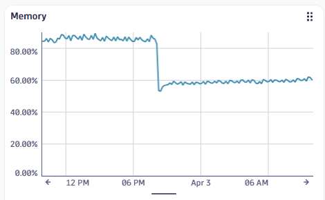

I am looking into the topic because we are having issues with execution of synthetic tests from a private location.
We have 39 Browser clickpaths and 21 HTTP tests running from a location that has a single Synthetic AG.
The AG had 2GBs of RAM and yesterday we upgraded it to 4GB. It has been restarted and not reinstalled/updated and I can see the new memory has been captured (the graph of memory usage):
In my understanding this should be sufficient and does not need a reinstall as I can see the memory increase in DT?
Also what do you think about the resources and the amount of Synthetics? We are planning to add a second AG to the private location. Have you experienced such issues with Synthetics?
In the private Synthetic locations status I see this:
Capacity usage is greater than 80% for at least one type of synthetic monitor or failure of any ActiveGate can cause usage requirements to exceed maximum capacity.
Any suggestions would be helpful!

@Georgi_Vuldzhev ,
You have a good count of Browser clickpaths. The ammount of steps might also be impacting, besides CPU consumed by the browser. You would certainly be better with one more AG.
