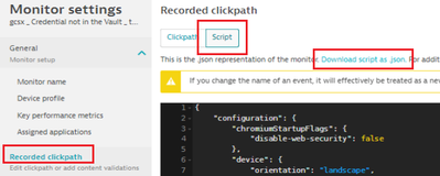

I would like to use the API to export the json files of synthetic monitors, about Broswer clickpath and it's events, to analyze their events. May I askd is there a way to do that? which API and parameters I shoud use? Thank you so much!
UI - where I could get the 'Recorded clickpath' json file, please see below picture:

I would use Monaco + download action for that purpuse.

I found the solution, use Synthetic Monitors API, capture all synthetic list of browser type first, then get synthetic use each synthetic ID, that will export clickpath events.
Yes, that is a valid option also. Monaco is using target API behind scenes. You can use Monaco or your custom script against Synthetics API.
