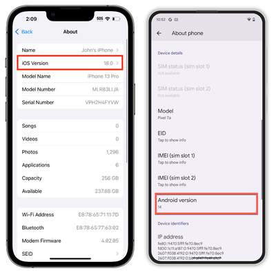

  • For SaaS customer:
     Make sure the device has access to the internet.
     Double-check the operating system version to determine if it is supported.

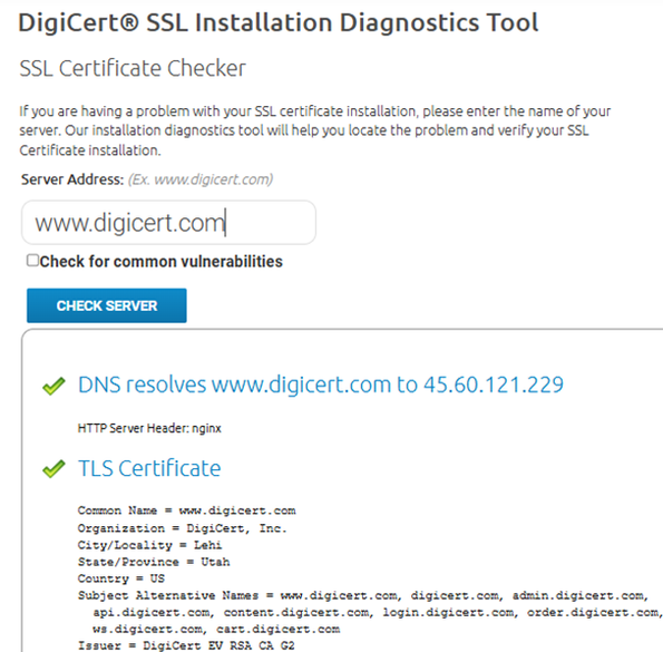

If a firewall is being used, it must allow incoming traffic to the Cluster ActiveGate through the designated port. Double-check that the domain name has a valid SSL certificate. Use the Digicert Checker page to verify that.

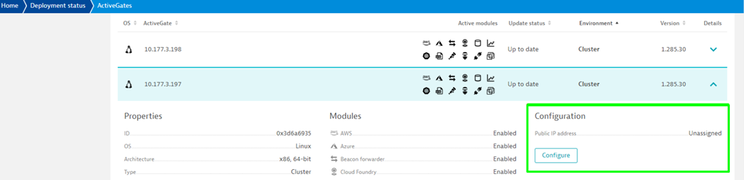

        One Cluster ActiveGate is installed, but it is not possible to configure a public IP address; what is happening?
In this case, ensure to have one Cluster ActiveGate, whose purpose is to route traffic. If there is already one, and it looks like the picture below, it would be the wrong one.
       When installing a Cluster ActiveGate, it would be needed to select the following option:
