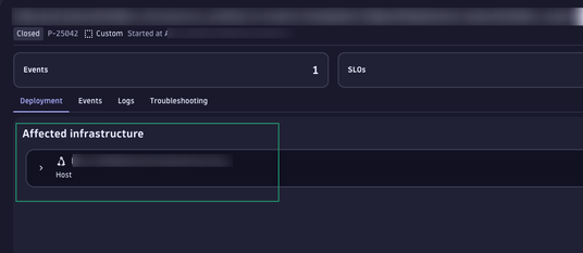

To check impacted entity for a problem check Problems application:
or Problems Classic application:
If you are not satisfied with entity presented there, take a look on logs related to the problem ("Logs" tab for problem in Problems application or "Analyze logs" link in Problems Classic application) to check if there are other entities available in log record in dt.source_entity attribute or in any dt.entity.* attributes.

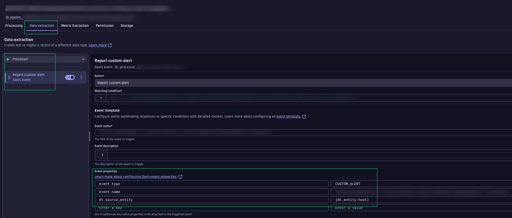

Add property in event template to override dt.source_entity attribute with preferred value. It is strongly recommended to use a placeholder for another attribute presented in log record that contains entity id you would prefer, for example:
{dt.entity.host} - contains id of the host entity from where the log came from{dt.entity.sql:sql_server_instance} - contains id of the entity created for extension of Microsoft SQL ServerIt could be done in settings for Classic events (Settings > Log Monitoring > Events extraction) :
or for Davis events in OpenPipeline ("Data Extraction" stage > "Davis event" processor) :
With this configuration change all new log events matching the template should be reported on the entity defined in the template properties.
