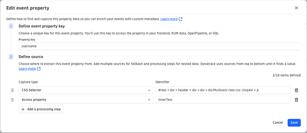

  6. Under Define event property key, set the Property key to a name you will reference later, for example username.
  7. Under Define source, configure the two capture rows:
    1. In the first row, set Capture type to CSS Selector and enter your CSS selector in the Identifier field, for example #root > div > header > div > p. This tells Dynatrace which DOM element to read.
    2. Select + Add a processing step. A second row appears.
    3. In the second row, set Capture type to Access property and set the Identifier to innerText. This extracts the visible text content of the matched element.Aaron_Schultz_1-1787507722826.png
  8. Select Save.

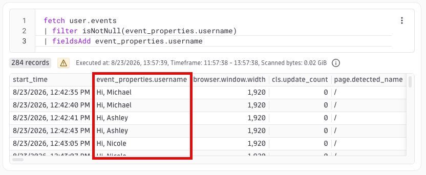

Before setting up OpenPipeline, confirm that the event property arrives in Dynatrace by querying for it in a Notebook.
  1. In Dynatrace, go to Notebooks and open a new notebook.
  2. Add a DQL tile and run the following query, replacing username with the property key you configured in Part 1:
    fetch user.events
    | filter isNotNull(event_properties.username)
    | fieldsAdd event_properties.username
  3. Confirm that the event_properties.username column is populated with the expected user names.Aaron_Schultz_2-1787507951836.pngNote: From the image, you can see that it also captured additional text, "Hi, " that you may not want. Do not worry, as we can create a clean up rule later.
If the column is empty, go back to Part 1 and verify the CSS selector and the innerText processing step are configured correctly. Generate new user actions in the monitored application (for example, load a page while signed in) and then re-run the query.

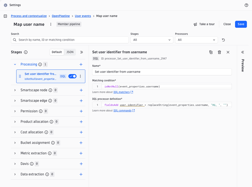

Part 3: Create a pipeline to map the user name
In this part, you create an OpenPipeline pipeline under User events and add a DQL processing rule to map the captured property to the user.identifier field.
  1. In Dynatrace, go to Settings > Process and contextualize > OpenPipeline.
  2. Under User events, select the Pipelines tab and select + Pipeline.
  3. Give the pipeline a descriptive name, for example Map user name.
  4. In the Processing stage, select Add rule and set the processor type to DQL.
  5. Configure the rule:
    • Name: Enter a descriptive name, for example Set user identifier from username.
    • Matching condition: Enter the following to only process events where the property was captured:
    • DQL processor definition: Enter the following expression:
      fieldsAdd user.identifier = event_properties.username
      Note: If your CSS selector captures additional text alongside the user name—for example, a greeting prefix such as "Hi, Priya", use replaceString to strip the unwanted text: fieldsAdd user.identifier = replaceString(event_properties.username, "Hi, ", "")
  6. Select Save on the rule.

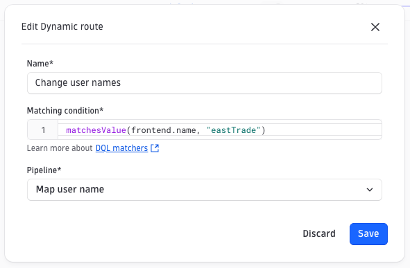

Part 4: Create a routing rule to direct data through the new pipeline
OpenPipeline uses the default pipeline unless a routing rule sends data to a specific pipeline. In this part, you create a routing rule that directs the relevant user events through the pipeline you created in Part 3.
  2. Under User events, select Dynamic Routing.
  3. Select + Dynamic route. The Edit Dynamic route dialog opens.
  4. Configure the route:
    • Name: Enter a descriptive name, for example Change user names.
    • Matching condition: Enter a condition that matches the application you want this pipeline to process:
      matchesValue(frontend.name, "Your App Name")
    • Pipeline: Select the pipeline you created in Part 3.Aaron_Schultz_4-1787508330885.png
  5. Select Save.
  6. If multiple routing rules exist, drag the new rule above any others that might match the same data so it takes priority.

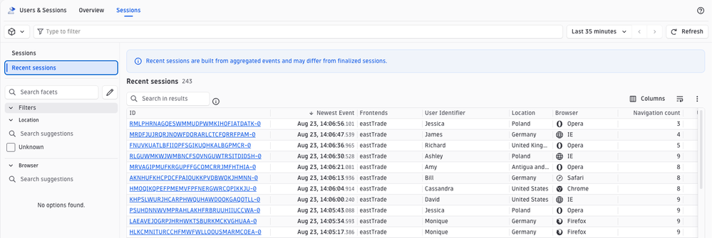

Part 5: Verify user names appear in the User sessions view
After completing Parts 1–4, generate new user sessions by interacting with the monitored application while signed in. Then confirm the user name appears in Experience Vitals.
  1. In Dynatrace, go to Experience Vitals > Overview > Web.
  2. Select the application.
  3. Select Open with User & Sessions to open the session list.
  4. Select a Recent sessions on from the top left of the page.
  5. Confirm the User Identifier field shows the name captured from the page.
Note: Only sessions ingested after the pipeline and routing rule were published display the mapped user name. Earlier sessions retain the generated identifier.
