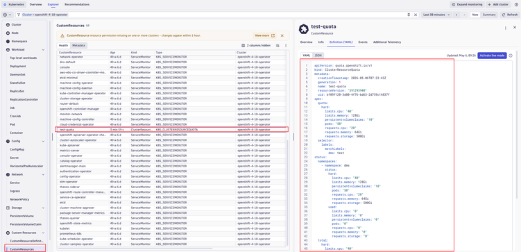

Hello @panumjp,
1) Can metrics collected through this integration (or any other mechanism) be displayed in the custom resource's Additional Telemetry tab in the Kubernetes application?
Yes, The ingested CR can be displayed on the CustomResources tab on the new Kubernetes App:
