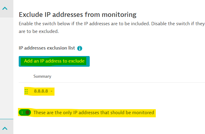

  1. Go to problematic RUM Application -> edit Settings -> Capturing -> Exclusions -> IP address exclusions ,
  2. Add the fake client IP and flip the These are the only IP addresses that should be monitored flag ON:

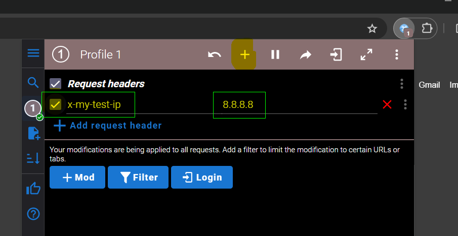

  1. Install ModHeader browser extension in your selected browser,
  2. Configure the name of the custom HTTP request header - make sure the name is unique, and the value is != other client IPs. The 8.8.8.8 might be a good choice.
    Example configuration:
    Note: The checkbox next to the name of the custom header disables/enables the header presence.

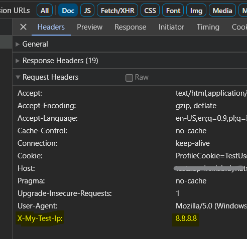

  3. Make sure the next request contains the header in HTTP:

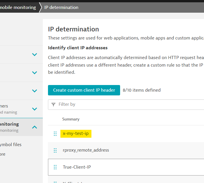

  1. Go to Settings -> Web and mobile monitoring -> IP determination
    Note: Ensure the created entry is at the top of the list.
  2. Go to the problematic RUM Application -> edit Settings -> Capturing -> Exclusions -> IP address exclusions ,
  3. Add the fake IP configured previously and flip the These are the only IP addresses that should be monitored flag ON:
