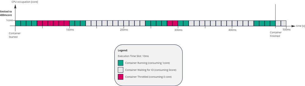

Suppose you have a container with a CPU limit of 400 millicore. Further assume that the container has the following CPU behavior over time.
Each small box represents the time course in 10ms. A green box means that the process in the container is running and requires CPU resources. A red box means that the process could run, but is throttled due to the CPU limit. A gray box means that the process is waiting for IO (storage, network, user, whatever) and therefore does not require CPU. Throttling is generally enforced in individual 100ms scheduling periods.

The metric throttled_periods_total increases by one whenever a container was interrupted during a period, although it was able to run. The metric periods_total increases every period by one as long as a container is running. The higher throttled_periods is, the higher is the ratio. This ratio is usual between 0 and 100%.
According to the throttling example above, let us have a look to the first scheduling period.
container_cpu_cfs_throttled_periods_total would be 1 as throttling occurred in this period. container_cpu_cfs_periods_total would also be 1. So ratio-by-periods = container_cpu_cfs_throttled_periods_total / container_cpu_cfs_periods_total = 1 / 1 = 1 = 100%.
container_cpu_cfs_throttled_seconds_total would be 0.06 as throttling occurred for 60ms. container_cpu_usage_seconds_total would be 0.04 as the container actual runs for 40ms. So ratio-by-seconds = container_cpu_cfs_throttled_seconds_total / container_cpu_usage_seconds_total = 0.06 / 0.04 = 1.5 = 150%.

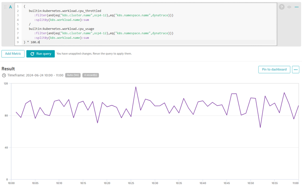

For the Kubernetes anomaly detection 'High CPU throttling' alert, Dynatrace uses the 'Throttling Ratio by Seconds' definition as described above. It is defined as dynatrace-throttling-ratio = builtin:kubernetes.workload.cpu_throttled / builtin:kubernetes.workload.cpu_usage. For exact definition see "High CPU throttling" in 'Workload alerts'. This value can be higher than 100%! See section "Throttling Ratio by Seconds" above.
To check the Dynatrace throttling ratio metric expression open 'Data Explorer' in Dynatrace Classic or 'Notebook' in the new Dynatrace Platform to execute the metric expression.

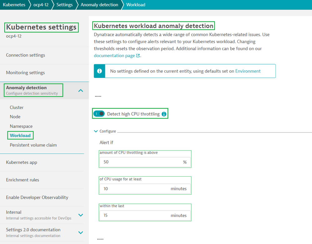

How the Dynatrace 'High CPU throttling' Alert can be configured
The alert can be configured in the 'Anomaly detection' settings on tenant level, cluster level or namespace level. These settings are structured hierarchically. The more detailed level overrides the value of the more general level. Specific settings on workload level are not supported!
The settings for the tenant level can be found in 'Settings' --> 'Anomaly detection' --> 'Kubernetes Workload'. The settings for the cluster and namespace level can be found in the cluster settings at 'Kubernetes settings' --> 'Anomaly detection' --> 'Workload'.
Enabling / Disabling: Using the toggle 'Detect high CPU throttling' (default: disabled), the alarm can be switched on or off for the entire tenant, for a specific cluster or for a specific namespace.
Threshold: The threshold for triggering the alert can be defined using the input field 'CPU throttling level is above' (default: 50%). As explained in the section 'Throttling Ratio by Seconds', this value can be higher than 100%.
Trigger Period: The value in the field 'of CPU usage for at least' (default: 10 minutes) specifies how long the threshold defined above must be exceeded in the total observation period defined below to trigger this alarm.
Observation Period: Finally, the value in the field 'within the last' (default: 15 minutes) indicates the total observation period.

Check the actual Dynatrace throttling ratio values for your desired workload. See section "How the Dynatrace 'High CPU throttling' Alert is defined".
Does the metric expression have data points?
If not:
  • Check if 'Monitor workload and node resource metrics' is enabled in the Kubernetes cluster monitoring settings.
  • Check whether all required rights are available on the Kubernetes cluster by clicking on 'Test monitoring features'.
  • Are there any data points available for the builtin:kubernetes.workload.cpu_usage metric on this cluster at all?
If yes:
  • Check how many data points are actual above the 'Threshold'. Consider also the 'Trigger/Observation Period'. Cross-check these observations with the defined alert settings.

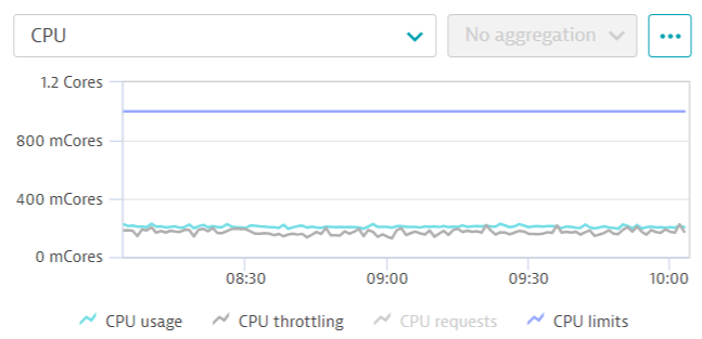

An alarm is triggered even though the usage does not reach the limit according to the UI. How can this happen?
The fact that CPU throttling occurs even though usage is below the limit does not necessarily mean it is a fault.
  • First, you should look at the guide "Troubleshooting Kubernetes CPU Throttling Problems in Dynatrace". This is answering questions like 'Why is my container CPU throttled although pod limits are set high enough and node has enough allocatable CPUs?'.
  • Furthermore, it should be noted that the throttling alert is not defined on the ratio usage / limit. It is defined on the ratio throttling / usage! See section "How the Dynatrace 'High CPU throttling' Alert is defined".
    • Check the actual Dynatrace throttling ratio values for your desired workload.
    • Consider also the 'Trigger/Observation Period'. Cross-check these observations with the defined alert settings.

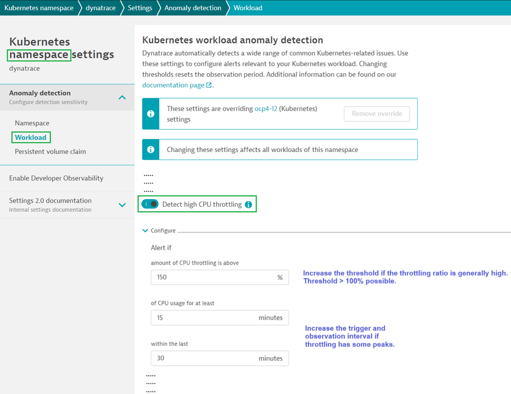

The alarm occurs far too often. What can I do?
For bigger clusters or clusters with general higher throttling, an over-alerting can happen.
The alarm settings are only default values that make sense for some typical Kubernetes use cases. However, not for all of them. If the alarm is triggered too often for your specific use case, you have the option of adjusting the settings to your needs down to the namespace level.
  • Increase the 'Threshold' if you feel it is too low and the throttling ratio is permanently high.
  • Increase the 'Trigger/Observation Period' if the throttling ratio has frequent spikes that should not trigger the alarm.

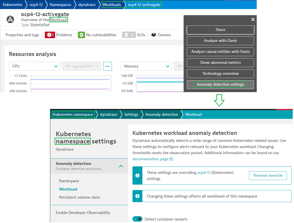

I have configured the alarm for specific workloads, but the values overwrite each other. Is this a bug?
Individually configuring an alarm for a distinct workload is not supported. When you are at workload details and click 'Anomaly detection settings' from the menu, you are actually forwarded to the namespace level settings.
Changes there apply to all workloads in that namespace. Doing the same form a different workload forwards you to the same setting page.
The alarm states that throttling is higher than 100%. How can this happen?
The calculation of the throttling ratio as used by Dynatrace can produce values over 100%. This is normal and intended. See section "Throttling Ratio by Seconds" above.
In the alert settings it is possible to specify a threshold above 100%. Increase the threshold accordingly (see section "How the Dynatrace 'High CPU throttling' Alert can be configured").
