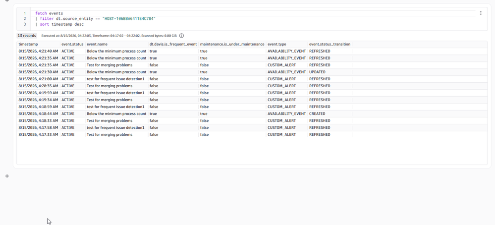

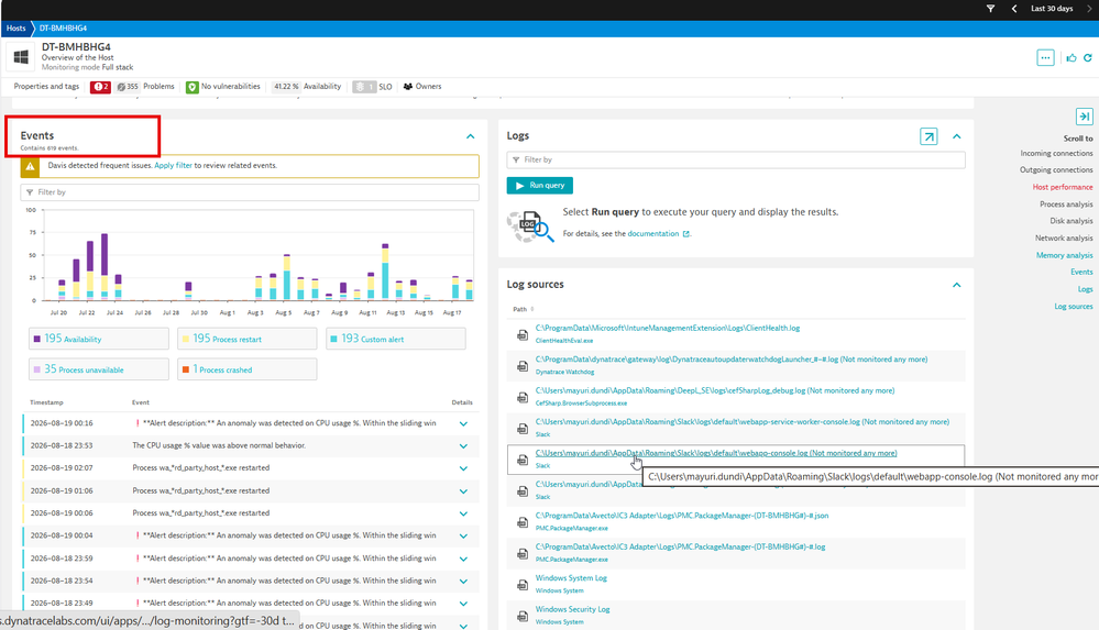

Confirm the event was actually generated
Problems are generated based on events. If there are no events, there is no problem. First, make sure that the event is present.

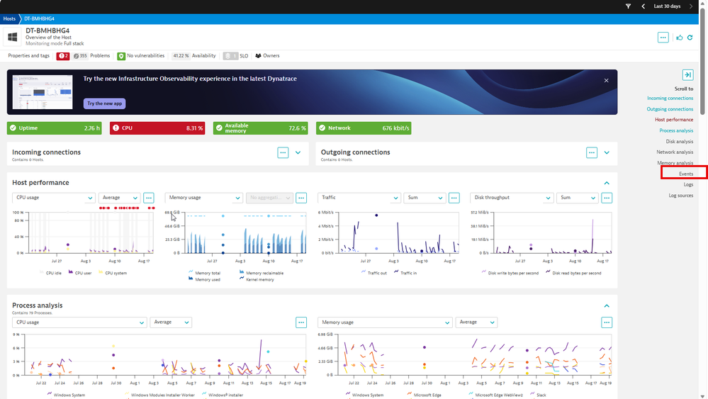

You can check the Events section of the entity page or query the data in a Notebook or Dashboard.

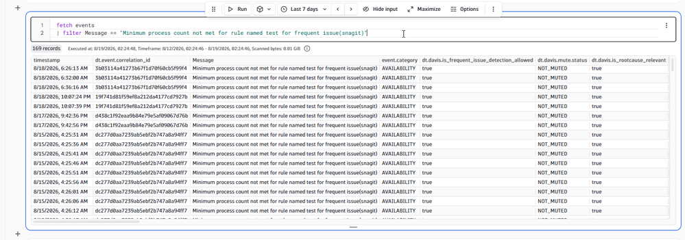

For example, filtering events for particular process instance:
fetch events
| filter dt.entity.process_group_instance == "PROCESS_GROUP_INSTANCE-F309E6AF540DAF55"
When no events are generated, verify the configuration of your anomaly detector, metric event, and problem generation settings. Make sure the data points match the sliding window configuration and confirm that anomaly detection is in a success state with the detector/metric event configurations enabled.

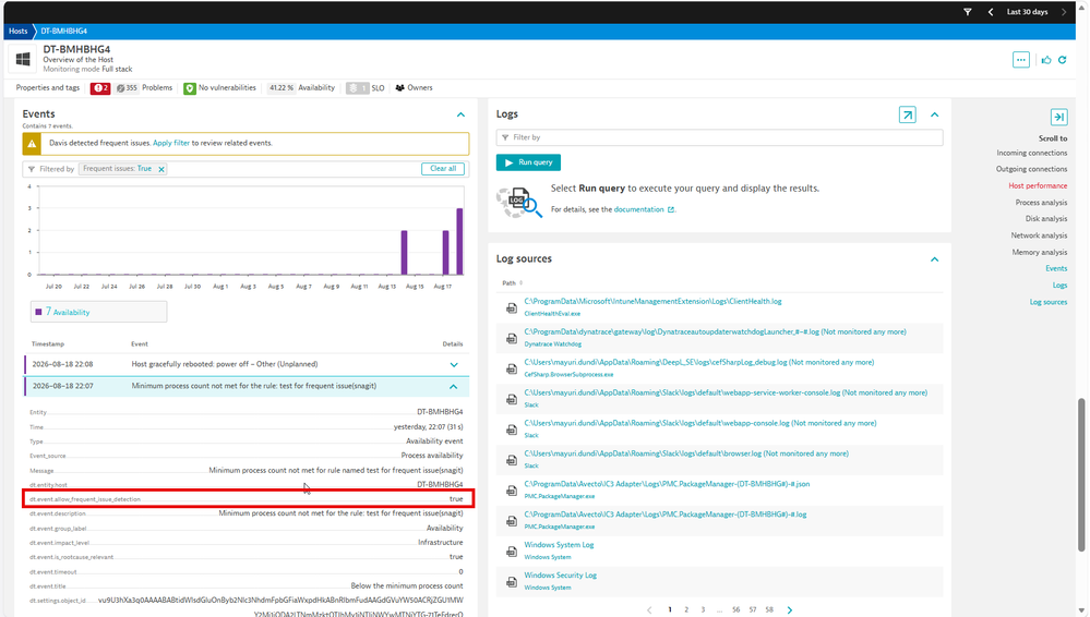

Check if the issue was classified as a Frequent issue

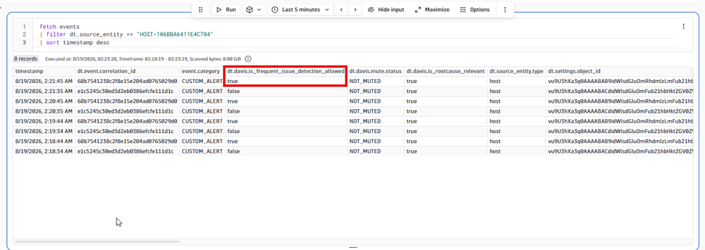

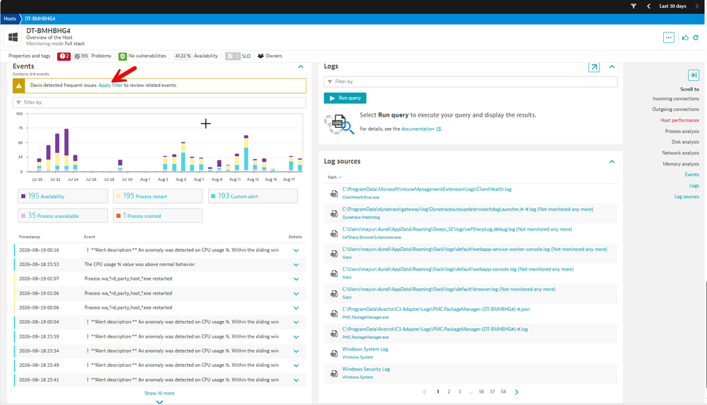

In the Events section of the entity page, filter for Frequent issue and adjust the timeframe to your investigation window. Compare the event timestamps against the time you expected the problem to appear.
Alternatively, use a Dashboard or Notebook and apply the same filters on event and entity. Check the property dt.davis.is_frequent_issue_detection_allowed  if the value is true,
the event is treated as a frequent issue, and no problem is generated.

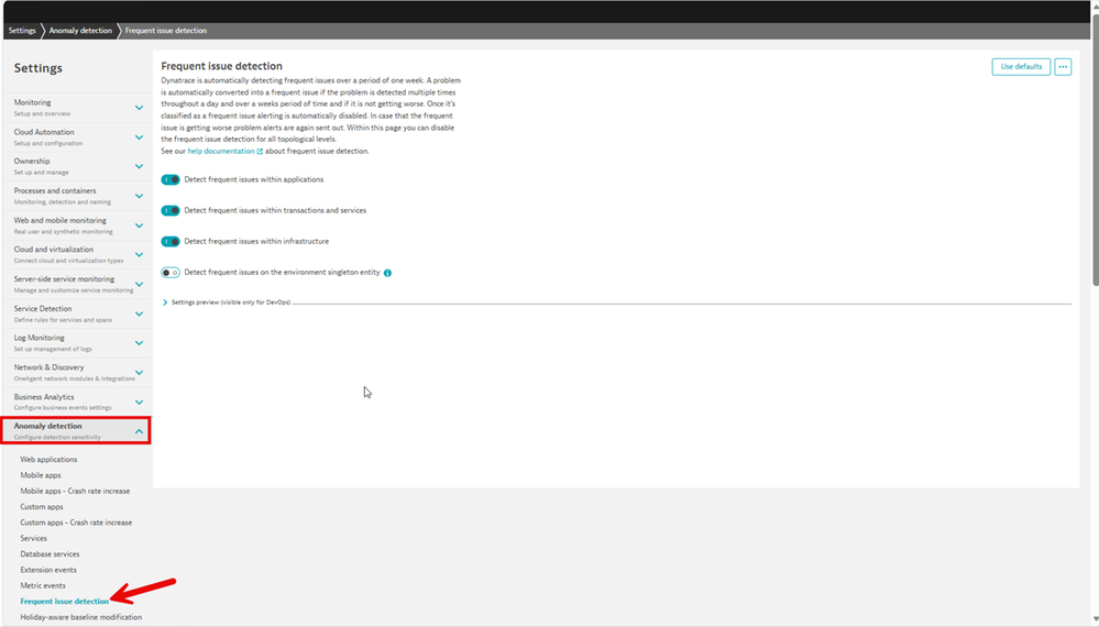

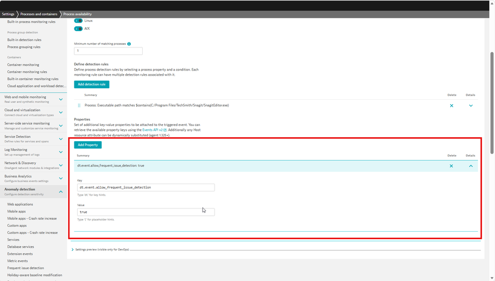

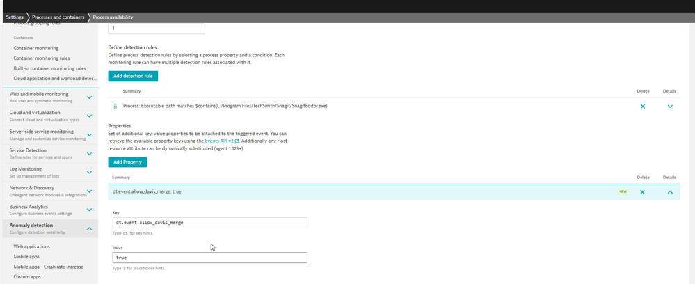

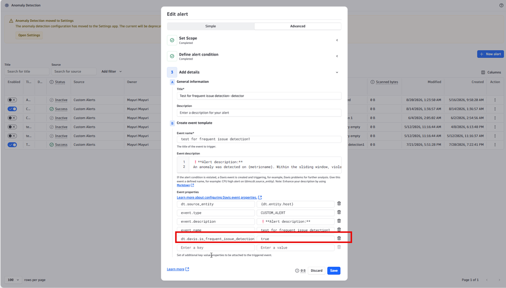

You can confirm whether frequent issue detection is enabled by checking the event properties of the anomaly detector, as well as under Settings (Classic) → Anomaly detection → Frequent issue detection or within any other alerting configuration you have in place.

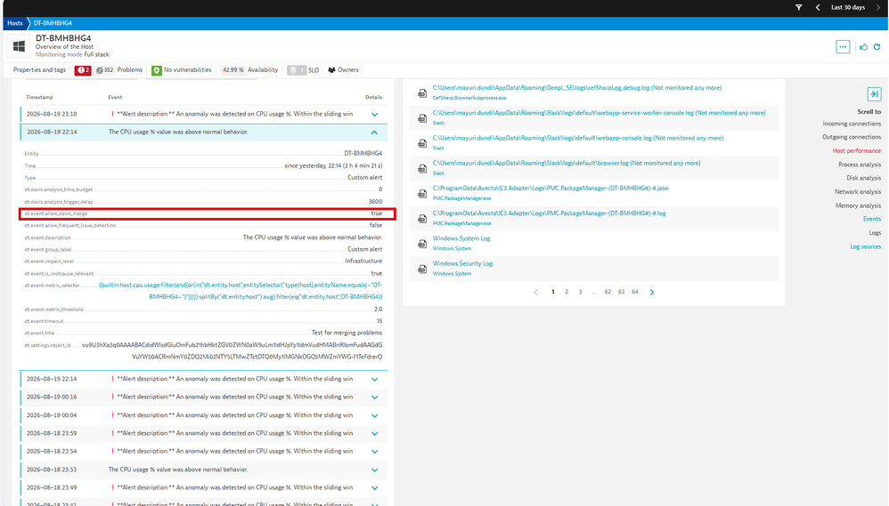

Check if the event was merged into an existing problem

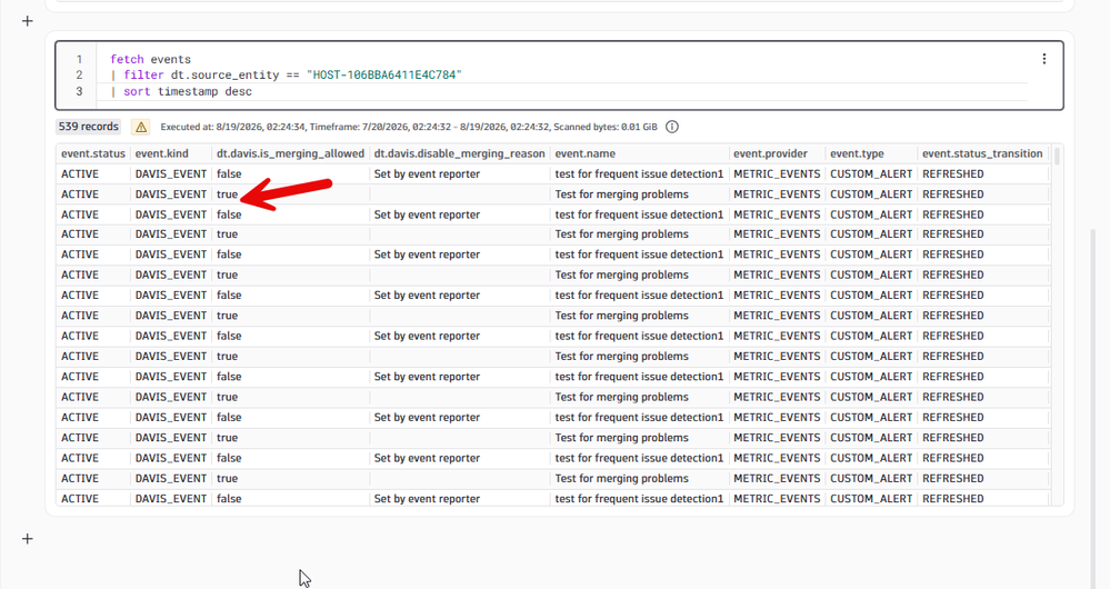

If there's already an open problem, a new problem can be merged into it. This can happen either just before the new problem is created (as events are generated) or immediately after. When this occurs, the merged problem won't appear separately in the UI. Merging takes place when the events share the same root cause or occur around the same time with a topology match (vertical stack).
To confirm whether new events or problems were merged into an existing one, first check whether an open problem already exists. Then look for the property dt.davis.is_merging_allowed in the event properties; if its value is true, the new events have been merged into the existing open problem.

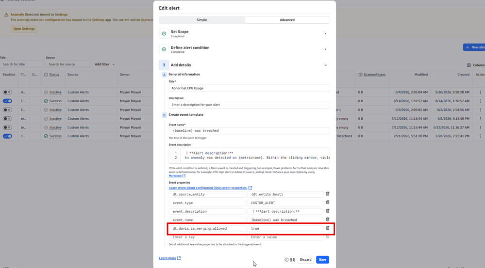

You can check if the merging is allowed in the event properties of anomaly detector and also any other alerting configuration you have.

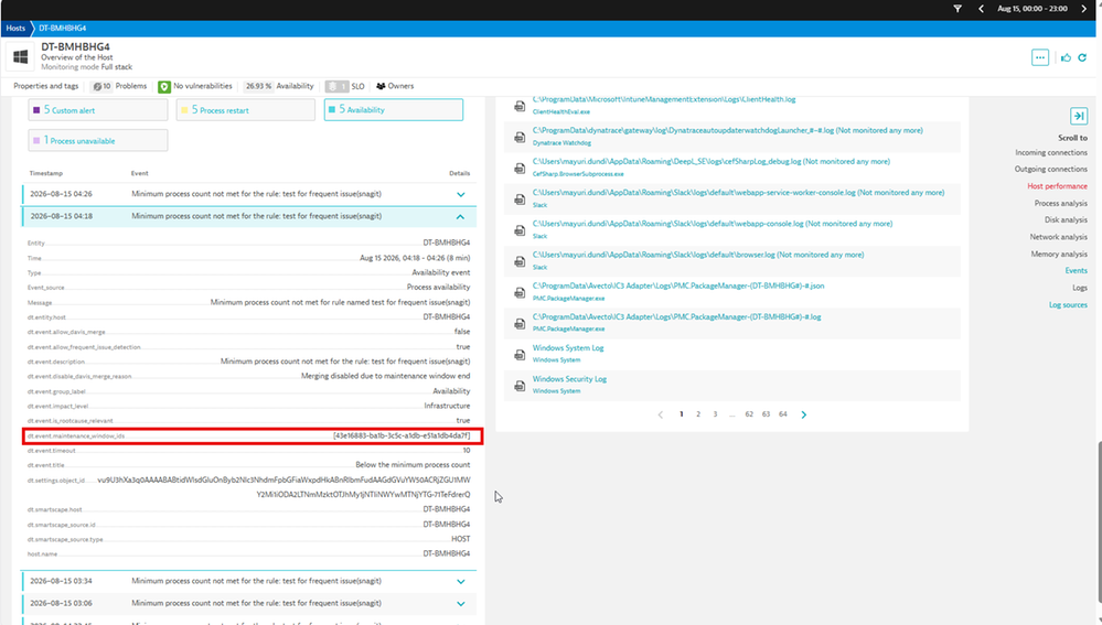

Check for an active Maintenance window

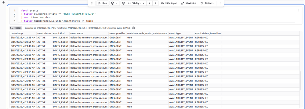

Depending on the maintenance window configuration, alerts and notifications can be suppressed. To check whether an active maintenance window is being applied to the event, look for the maintenance.is_under_maintenance property. If its value is true, a maintenance window is applied to the event and depending on its configuration the alert or notification may be suppressed.
Note: Maintenance window is applied to the event timestamps not to the problem duration timestamps

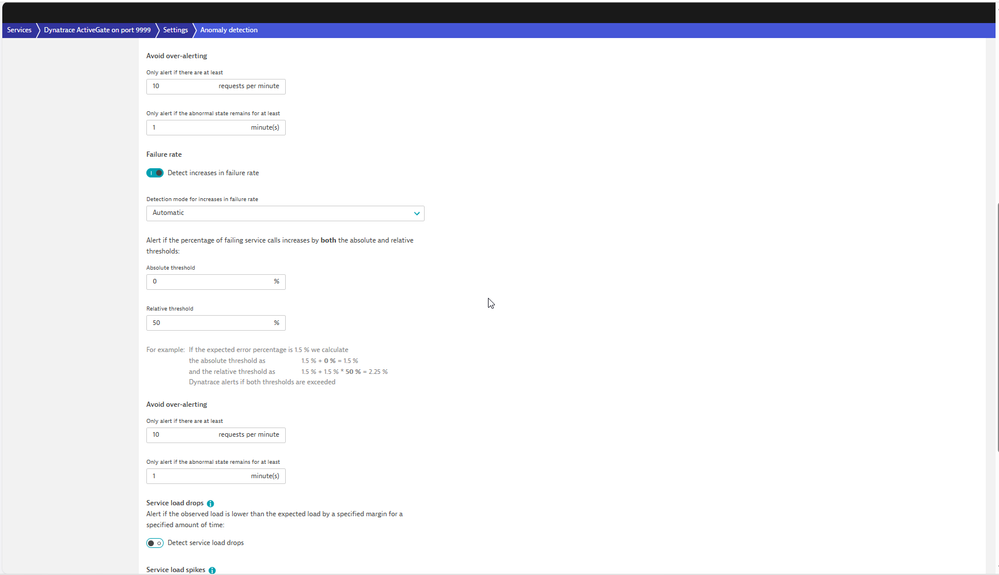

For built-in service failure-rate detection, Dynatrace compares the current failure rate against the service's expected baseline. An event is generated only when all configured conditions are met:
  • The current request volume meets the minimum requests per minute requirement.
  • The abnormal condition persists for at least the configured duration.
  • The failure rate exceeds both the configured absolute and relative thresholds.
Example scenario:
Assume the configuration is:
  • Minimum requests per minute: 10
  • Abnormal state duration: 1 minute
  • Expected failure rate: 15%
  • Absolute threshold: 0%
  • Relative threshold: 50%
Dynatrace calculates:
  • Absolute threshold = 15% + 0% = 15%
  • Relative threshold = 15% + (15% × 50%) = 22.5%
Since both thresholds must be exceeded, the effective trigger point is 22.5%.If the failure rate rises to 25% but the service processes only 5 requests per minute, no event is generated because the minimum request volume condition is not met.Likewise, if the failure rate rises to 25% and the service processes 20 requests per minute, but the condition lasts only 30 seconds, no event is generated because the required duration has not been met.An event is generated only when the failure rate remains above 22.5%, the service receives at least 10 requests per minute, and the condition persists for at least 1 minute. Since problems are generated from events, if these conditions are not met, no failure-rate event and therefore no problem will be created.
