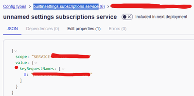

21 Aug 2026 08:27 AM
hi @arild_palencia3 ,
You can migrate key web request with SaaS Upgrade Assistant.
You can find your key web requests in "builtinsettings.subscriptions.service" config type
Hope it helps.
Regards,
