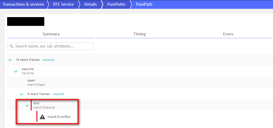

Hi everyone,
I want to know how to setting to alert when in the purepath/transaction have exception, i.e. when have message "lock" is in transaction the dynatrace is send alert to operation team. It's can do it ?

You can setup custom handled exceptions for the RTE Service under RTE Service Settings -> Error detection or create custom error rules using request attributes. You can then setup either a custom alert for this or configure your anomaly detection rules to create a problem whenever this error occurs. You should then configure an alerting profile and problem notification rules to alert you on this.
See links below
Custom error rules using request attributes
Custom handled exceptions
Alerting profile
Hope This Helps
