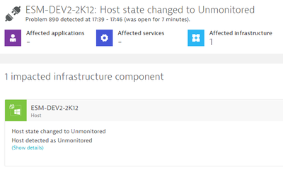

Hello community,
i have an host with Oneagent installed. Then, i stop Oneagent process from host console, so in Dynatrace i see this host as unmonitored (i don't shut down any other process or whole host).
So, in this case Dynatrace doesn't alert me. I have already switched on all default host alert options.
My question is, how can i have an alert if an host become unmonitored, like in image?
Thanks,
best regards
