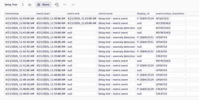

Here is a screenshot with the events and problems from the above scenario:
The datapoint with value 15 for the metric was ingested at about 11:39:30 AM.
At 11:40:05 the metric event configuration created the first event and created the problem P-xxx529
At 11:42:43 the anomaly detection configuration created the first event and created the problem P-xxx531
That is over a 2 and a half minute difference between the two. And these results are pretty much the same on every test case we've had, either real scenarios or simulated.
