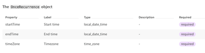

When I dumped the JSON for one of my maintenance windows, the onceRecurrence looked like this:
"onceRecurrence": {
"startTime": "2020-09-26T22:50:00",
"endTime": "2020-09-27T00:00:00",
"timeZone": "America/Los_Angeles"
You're missing the date in your start and end times.

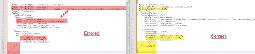

@Naveen there are several Syntax errors in your Json. please use the following to post your MZs via the API. You will need to update the start/end time tho.
  "scope": "environment",
  "schemaId": "builtin:alerting.maintenance-window",
  "schemaVersion": "2.14.2",
  "value": {
    "enabled": true,
    "generalProperties": {
      "name": "Maintenance windows",
      "description": "Maintenance windows are typically planned, recurring periods of system downtime during which your DevOps team can perform preventative maintenance and system upgrades outside of peak traffic hours.",
      "maintenanceType": "UNPLANNED",
      "suppression": "DONT_DETECT_PROBLEMS",
      "disableSyntheticMonitorExecution": true
    "schedule": {
      "scheduleType": "ONCE",
      "onceRecurrence": {
        "startTime": "2023-07-25T13:45:00",
        "endTime": "2023-08-22T14:45:00",
        "timeZone": "Europe/Vienna"
    "filters": []
So what were you missing?
1 - Schema Version was missing
2 - Conflicting names and descriptions
3 - No Date with your time stamp for both start and end
4 - Missing the filters segment
5 - Bracket/Braces were not correct.
Please save this as a gold template for you to leverage with posting of MWs via the API
-Chad
