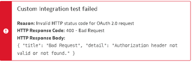

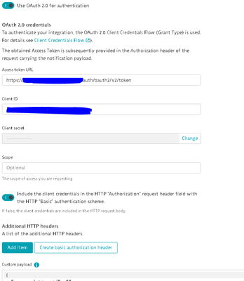

Im having troubles using the custom integration for problem notification when i activate the oAuth authentification.
The end point api expect the basic authentification in the header, i checked the option :
but all im getting is :

Are you creating basic authentication using this button?
Best regards
Hello,
Dynatrace does not accept an additional Authorization header if oAuth is checked.
No basic Auth header created, no aditional headers, tried with headers like: Accept and content-type but still the same issue. Also tried adding the scope but still nothing.
